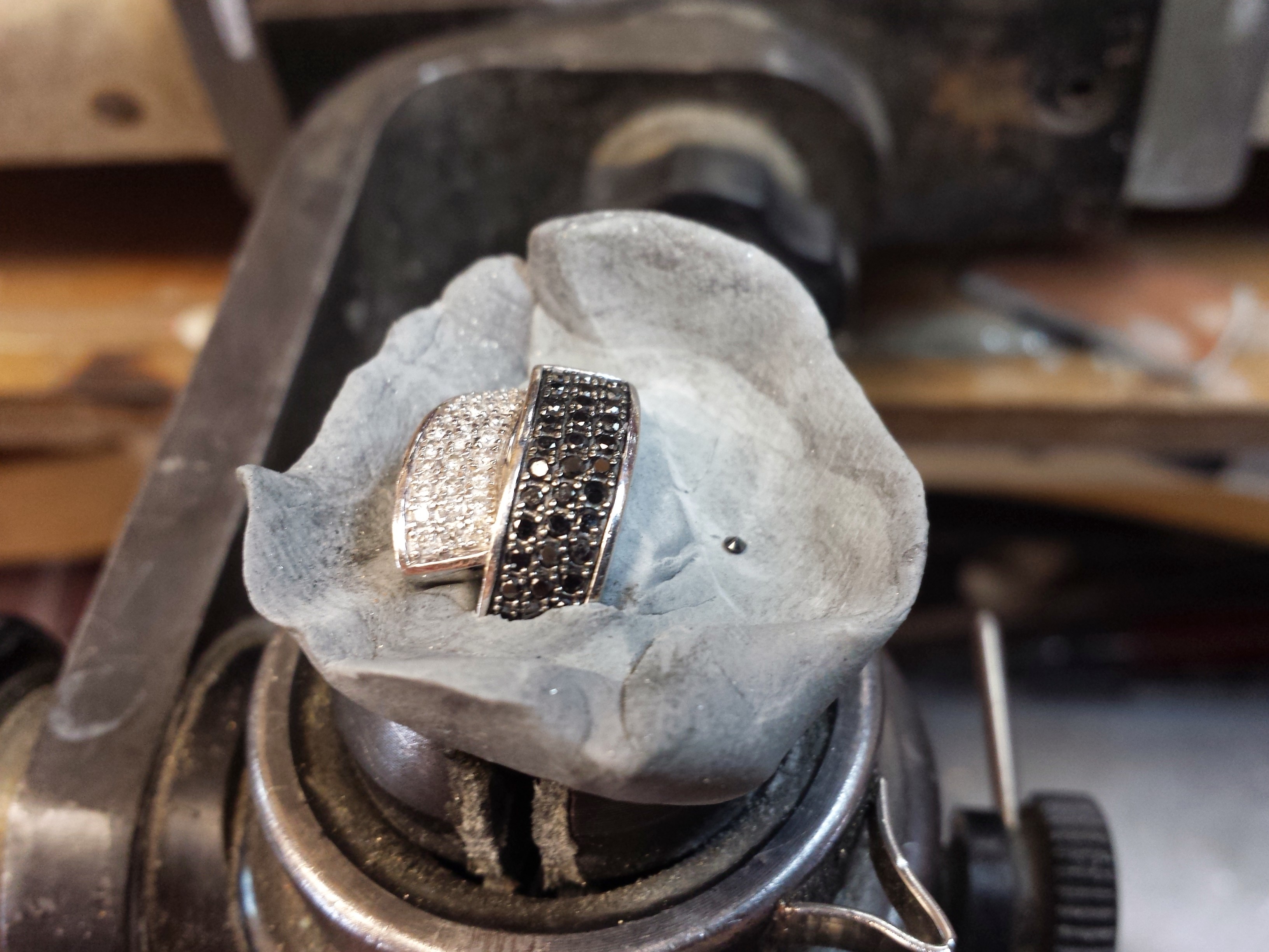

A little time saver. Been using this stuff for catching gems when
setting. It will save you from dropping and looking for tiny little
stones.
Works as a shelf and a catch all an when gems decide to go on
walkabout.

Hello Shannon,
Your ‘stuff’ looks like knead able eraser from a long ago drawing
class.
Great idea and thanks for sharing.

Ok. So, what is it?
Vicki S.
Your 'stuff' looks like knead able eraser from a long ago drawing class.
It’s poster putty or kneaded eraser, which I think might be the same
stuff. I did post this somewhere else and did add that important
so I’m not a complete moron.

Great idea. I pulled out the Silly Putty that I keep on hand in my
studio and it works just like the kneadable eraser.

That cup is a good idea. Might try GRS thermoloc, thermo-plastic,
instead of poster putty because it would stay put and hold it’s
shape. Mark
The problem with thermolock is it cures too hard. Would actually be
bad in this situation. Not easy to remove and stones would want to
bounce off of it. This stuff gems stay put and you can mold it on the
fly. You need a little more here or there you may push it there right
now not after hearing it up in water.
Thanks Lemel Man! A good tip and a knee-saver!
Right you are. That thermoloc probably is too hard and slippery for
this job. Thanks again for the tip. Mark

I use the poster stickum for all kinds of things in the studio. If I
am trying to hold something, especially a 3D item, I press it into a
lump of the stuff. It even works as a rather poor eraser.

however it might make for a good external lining - hard rigid
outside, putty sticky inside…
