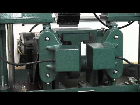

Hi all
modern bead machines produce stone spheres that just need to be
drilled.
How other beads are made, such as glass, involve some machine and
hand work.
all the best
Richard

https://www.youtube.com/watch?v=liZbOki2T7k
https://www.youtube.com/watch?v=102Z_OP4rFE
Thank you for the videos on bead making and cabochon making
machines.
Imagine then a stone-working factory with a sequence of robotic
lapidaries, each specialized to do a particular job from the
cutting/carving/grinding of beads to cabochons to carving the statues
as we have seen in various videos here.
Then along comes the Robots Union and…
